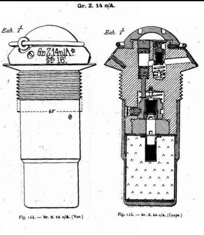

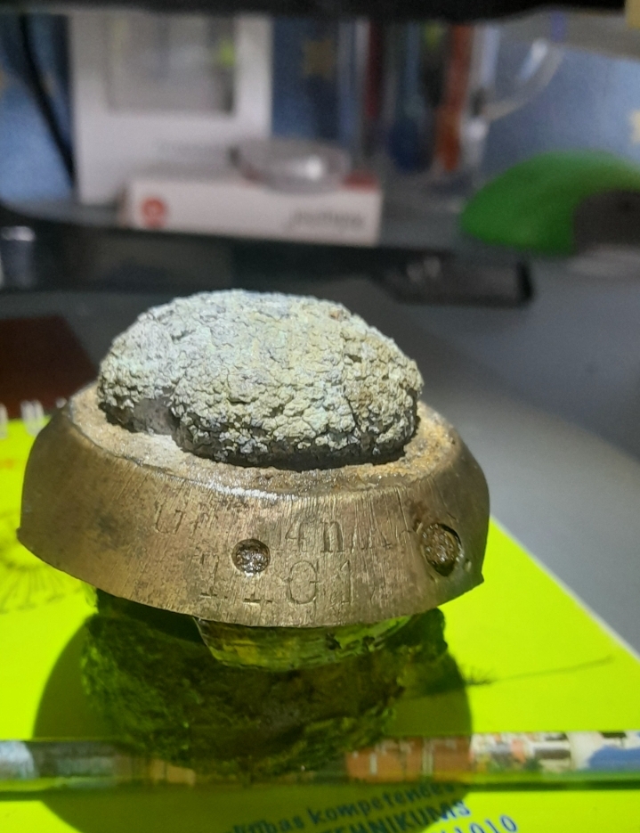

So recently i found this german Gr.z 14 N/a fuze☆ (T.T.G 17)
Nothing special , but the question is :

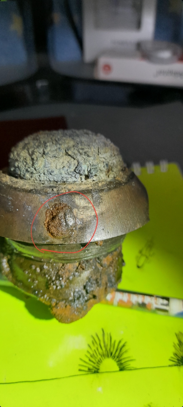

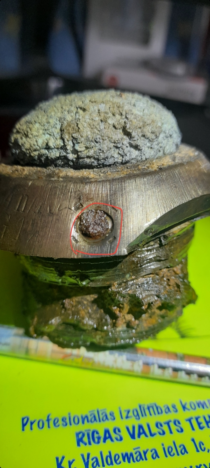

Whats the purpouse of this big back screw , wich cant be seen at the scheme , and why does the gas exsit hole have a screw in it?
I mean its obviously not a leftovers of the protection ring...

Hello,
The GrZ 14 n/A fuse has its tapered part initially covered by a steel plate fixed by 2 screws.
What you see are the remnants of that steel plate and the screws that held it together.
Initially on the GrZ14, there is an air groove at the level of the primer holder of the percussion system.
On the GrZ14 n/A, this air groove will be removed and applied to the tapered part of the fuse, hence the attachment of this steel plate on which the fusee's inscriptions are transcribed.

Thank you for responce.
It confirms that its just a regural fuze.
