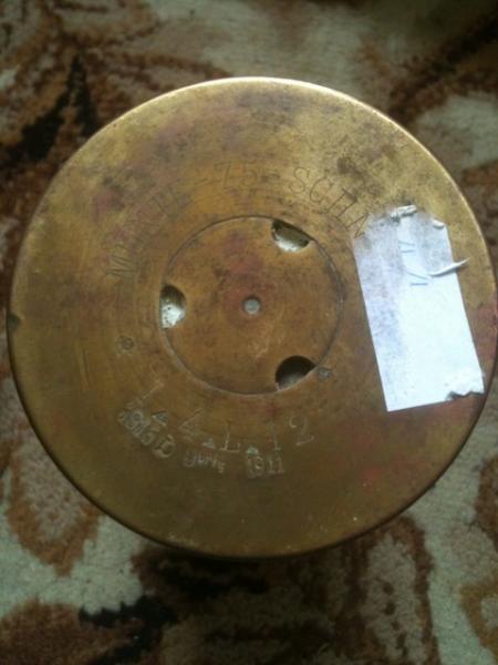

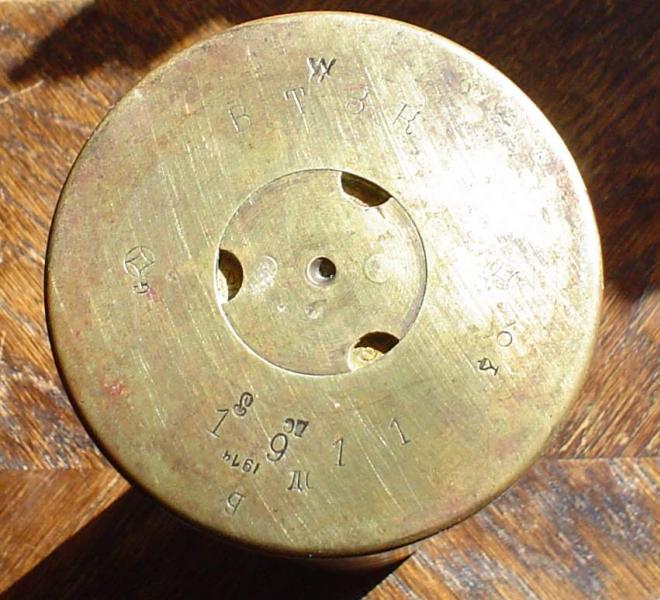

I look after the website Landships II (landships.info). Occasionally we get queries about WW1 era equipment. A recent query was from Hungary about
two cartridge cases (attached). The first appears to be Rumanian but manufactured in France and the other seems to be Russian.
The Rumanian cartridge case is 75mm diameter and 165mm in length. Opinion on English language forums was that it used in Schneider mountain guns
sold to Rumania before WW1.
The Russian case is 75-76mm diameter - 227mm length. My guess is that it was for a 76.2mm Putilov M1902 gun.
Can anyone on this forum add more detail about these cartridges?
Regards,
Charlie

Bonjour Charlie,
Est ce que c'est possible de nous donner le diamètre exacte du culot de ces douilles?
La deuxième douille n'est pas Russe,mais Allemande fabriquée par Rheinmetall.
Amicalement,François
Is it possible to give us the exact diameter of the cartridge case bases?
Your second case is not Russian,but German made by Rheinmetall.
Ferraille
