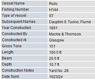

See below an entry in the Lancashire FLOAT website which seems to tie in with what you said. However, the only bit that doesn't tie in is the Defino II bit. If you take that out, it all sort of works:
Ruby 1891-1913 (Ratified by the card index taken from the Companies records).
Dauphin 1913-1915 (Trawler at Arcachon)
Dauphin II 1915-1917 (Flotille de l'Atlantique)
Tuono 1917-1920 Italy
Fiume 1920 - 1923/24 (SUNK)!
Any further information on 'Stricken'
Who is O.N.C. Naples?
Afterall the change of name from Dauphin II to Tuono mid ownership doesn't really work.??
